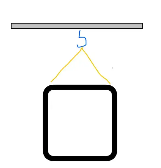

So I'm thinking of hanging it from the ceiling, which is reinforced concrete. I devise two ways for this. Which one do you think it's best?
First method : mobile with line/chain Schema of cabinet hanging from two lines, both connected to a single eye screw

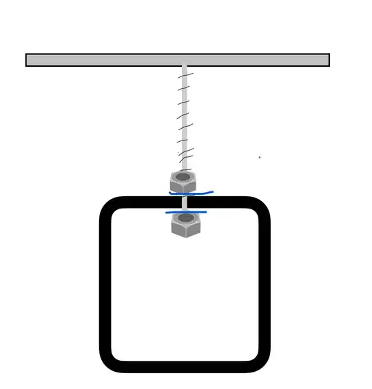

Second method : fixed with threaded rod. Secured with nuts and washers (blue) on top and bottom. Schema of cabinet with a threaded rod through it and the ceiling
Note that both are using only 1 hole in the ceiling, because I want it to be minimally invasive.
For that, I'm considering using this type of bolt : https://www.hornbach.ch/de/p/messing-spreizduebel-msd-m10-34-25-stueck/8229615
(is it called brass anchor?)
I'd get the M6 size, or even smaller if I can find. Because the total weight to hang is 5 kg / 11 pounds. Might go up to 10kg/22lbs if I add some more drives in the future.
So, what do you think? I'd any if these preferred? Or any other suggestions?

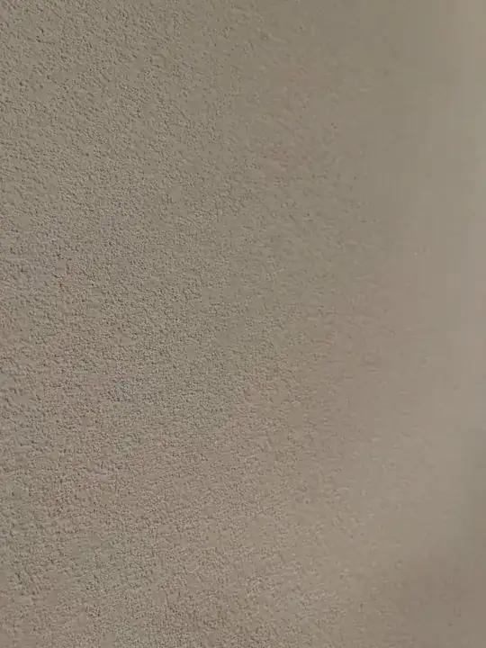

Edit : I'm attaching a photo of the wall to illustrate why I'm reluctant to pierce it. It has this extra layer on top of the boards, about 2cm thick) and with non uniform look. So holes will be very very visible even after patching, since you cannot sand it
Photo of the wall
