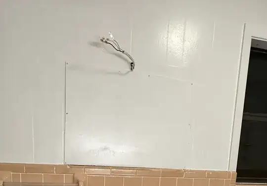

I am mounting a 24 inch vanity light into wood panel walls. The light fixture is lightweight and there is no stud available, so I intend to use this 1 gang old work round electrical box.
I need to know if a 4” hole saw and my drill is a good choice for these wood panel walls. How can I minimize damage to the paint and the wood panels? I’m very concerned about splintering since the wood splinters easily.
The bathroom used to have a recessed medicine cabinet with a light on top and the light switch on the side, so I attached a thin piece of wood to cover up the hole. Next, I’m wiring the new fixture to a combo switch with an outlet. The outlet and light are protected by a GFCI outlet upstream.
