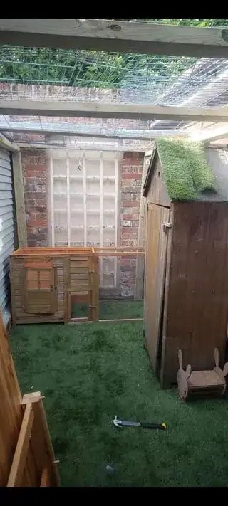

We have a small enclosed concrete garden that we converted into a living space for our two rabbits. We laid artificial grass down directly on the concrete, but when it rains it gets very waterlogged.

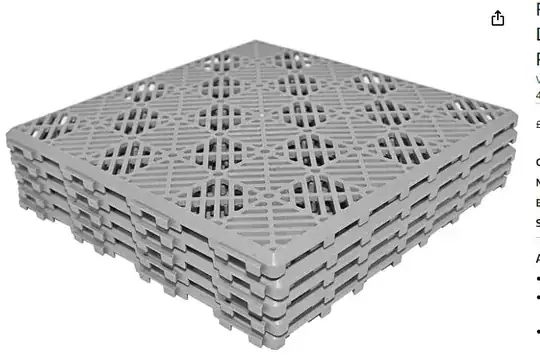

Plastic tiles are the way to go even if a bit more expensive. These are not too bad https://www.amazon.co.uk/dp/B09R25YM1H (this is not a product endorsement) enter image description here
