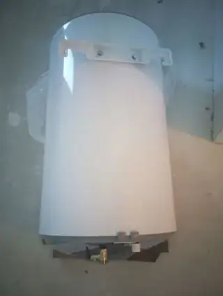

We want to mount a water heater on a wall. The stability requirements are high - the heater will have over 100 kg total weight when full, and we're in a seismically active zone.

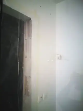

Unfortunately, when my father made the holes, he hit an electric cable. Here you can see the heater and the wall; the holes are in the upper-right corner of the wall. The cable is under the right-side hole.
heater
The problem is that we will have to repair the cable, and then we won't be able to place the hole in the same position.

At the same time, we don't really have another option for placing the heater. The mounting plate was attached to the heater by the manufacturer and can't be moved along the heater's body. The heater can't be placed away from the originally planned position: to the top, the ceiling is in the way. To the bottom, there are the water pipes for the heater. To the left, there's the bathroom door, and to the right, there's the wall. We also can't mount it on the wall to the right, because that's a weak drywall masking a ventilation shaft. So the only places we can drill new holes are within maybe 5 cm of the original holes, within the same already-weakened brick.

You can move the heater down a few centimeters, drill new holes wherever you think they will work, and you flexible connectors to connect the existing water pipes or cut them to the right legs.
You can use metal strut channel or plywood, mounted to the wall in any useful way, and then you mount the heater to that. Very flexible.
