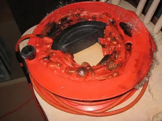

And my favorite picture of what can go wrong:
dangerous cord
