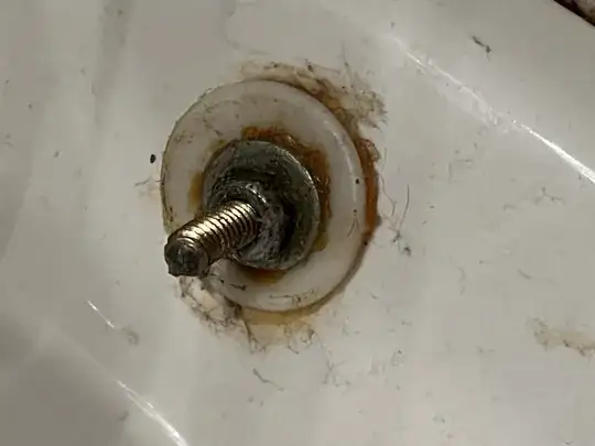

picture of floor boltI replaced the wax ring at the bottom of the toilet because it seemed like there was a slow leak. Since then, the toilet feels slightly unsteady when sat on. This is the second toilet I've replace a wax ring for and the first feels totally stable, so I don't know what to do about the second toilet. I've tightened the bolts a couple of times. I don't want to crack the porcelain, so I've been cautious about tightening the bolts. I've attached a pic of one of the bolts. I've considered getting a bigger metal washer to lay over the plastic washer, to be sure the metal is laying over the porcelain, but I don't know if that's the right approach. What should I do to improve the stability of the toilet?
UPDATE: Sorry about the pic. It's added now.
I disconnected the toilet from floor. The wax seemed okay. There was no leak. I went to Lowes and got a metal flange repair and one of the Perfect Seal wax replacements, like this: image of perfect seal from Lowes.com
The PVC flange seemed unbroken, so it seemed like I didn't need the metal flange replacement. I removed all of the wax ring that I had installed a few months ago. I laid the new Perfect Seal on top of flange and then replaced the toilet. The toilet barely sank. I'm not a big person, less than 150 soaking wet, pressed as much as I could. The toilet was getting nowhere near the floor. So I think the problem is the PVC flange itself. While unbroken, I think it's too far above the floor. I took off the perfect seal, since the toilet was nowhere near the floor. Back to Lowes, got one of those regular wax rings and tried like hell to get the toilet closer to the floor. It's better than the perfect seal, but it's still a little bit high. I looked and looked for one of the reusable plastic rings, as suggested in one of the answers, while at Lowes but all they had was wax rings and perfect seal like items. Now, I wonder if the PVC flange has to be redone. If I can find that plastic ring, maybe not (maybe it'll sink a little more?). Otherwise, it seems like the wax rings are a little too much wax. Anyway, the toilet is not leaking, it's also not as stable as I like, but we'll make it work until I have more time and motivation. Thanks for all the support. Great forum.

The toilet rests on the floor. If the flange is WAY too high (unlikely) that would be a problem but otherwise, remove the toilet, repair the floor if it's very uneven, use a new wax ring and use plastic shims to correct imperfections. The toilet should reset flat and without rocking before you put the bolts on.
Silicone around the front and sides of the toilet to keep it and the shims from moving relative to the floor.
THEN add the bolts, and not too tight, to keep the flange and wax ring aligned over the long term. The bolts are not holding the toilet to the floor.

The toilet flange may be cracked and as you tighten the bolt/ s the flange just bends.
If you want to be sure, remove the toilet and check the flange. I have found quite a few that cracked at the bolt slots. It could be what was causing a leak in the first place.

I've had this problem a few times. The cause is usually a combination of these:
  1. The floor is not flat, and crests in the center line of the toilet, so the toilet cannot fully seat on the flange and rocks side to side. Solution: plastic shims, like the ones used in flooring.
  2. The flange is not property attached to the subfloor and/or is attached to rotten wood. Solution: remove the flange and make sure it's screwed on to solid wood.
  3. The flange itself is broken. This is fairly common, as most are made out of plastic. Solution: Flange repair/replacement kit. Oatey sells several, all good in my experience.

Maybe the underlayment is rotten.

We had a similar problem at the house I grew up in, where the floor had settled due to age, while the outflow pipe for the toilet stayed the same height, so it was teetering on just the pipe instead of being equally balanced by the floor on all sides.
My dad used some kind of hard rubber strip around the whole outer rim of the base to prop it up. It was even the same color as the toilet (blue) so maybe they make it specifically for that.
But the wax ring should compress more over time, and it may be you just need to let it do that. You did say it wasn't rocking til you installed the new ring, and if the old one was fine, I don't see how the new one wouldn't get to that point eventually too. Some materials you can't mold quickly, they're too hard, and it takes steady pressure over longer time to gradually mash them.
I have a vague memory of cracking a toilet somewhere by tightening either the floor bolts or tank bolts too much, and it being easier to do than you'd think.

Make sure the toilet bolts are in the flange slot properly and that the flange is screwed to the floor, if not when you tighten the toilet bolts they will either come out of the slot and not tighten to the floor or if flange not screwed down it will move when sat on
