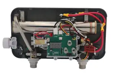

As usual there is a temperature probe on the inlet, and a pressure sensor on the outlet. If it is smart it will adjust heating power depending on inlet temperature, but there will be a delay until the temperature probe registers the change in temperature so it could still heat the hot water for a moment and burn the user. Only way to know is to try it out!
I don't see anything that would be damaged by hot water, it's all metal...
...except the triac, which is cooled by the cold water pipe. At 30A it's going to dissipate about 30Watts which is quite a lot ; there is no way to calculate the temperature rise without more specs about the waterblock. So it may overheat and burn, or maybe not. Normally the heating should stop once the hot water arrives, so maybe not.
It's only 6kW, so if you want to heat the water by 25°F (60 to 85°F) or 15°C (15.5 to 30.5°C) you will have to restrict flow to 6000/(4180*15) = 0.1 l/s or 1.6 gallon/minute which is a bit wimpy.
