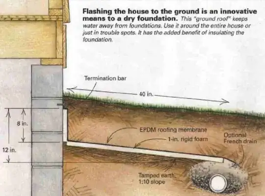

For the sloped and flat garden beds, I want to regrade the area immediately adjacent to the walls. Can I simply add some more soil to the top and grade it away from the wall? It would be a good amount below the foundation but it would still touch the siding. Also, moving around the existing soil in some parts might be more difficult due to the existing plants in the way. I was also thinking of digging a few inches below the grade first and line some roofing material against the EIFS wall to also help keep water away and limit soil contact, something like this:
Not sure if I can lay as deep or wide though. .
TL;DR - Water leaking in to garage/basement after heavy rain, want to regrade beds next to wall to divert more water away. Siding covers foundation and extends a bit below grade - but seems to be in great condition even with soil contact for over 20 years. Wondering if it's still ok to put soil next to wall as the foundation is already high enough, even though it'd make contact with the siding? Probably a more permanent fix is needed but wanted a short-term solution in the meantime.
Can I put some sort of underground flashing (e.g., roofing membrane) right next to the wall to keep water and dirt away? What material should I use, and how should I install it?
