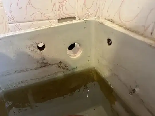

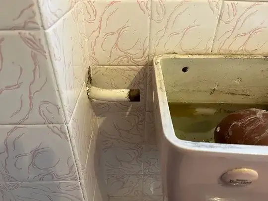

  • The overflow pipe has an outer diameter of about 22mm (I haven't found my calipers yet after the move, so used a tape measure as best I could). The end of the pipe is about 23mm from the outside wall of the cistern, and the cistern wall is about 8mm thick. The hole in the cistern measures approx 1"/25mm across.
Here's the setup:
Arrangement of pipe and cistern

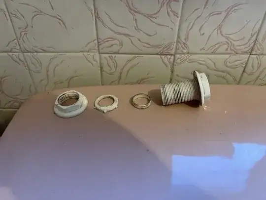

Here are the remains of the original connector. Note, critically, that the threaded part was inserted into the cistern hole from inside the cistern, passing over the end of the pipe where a nut provided some compression.
Remains of original plastic connector

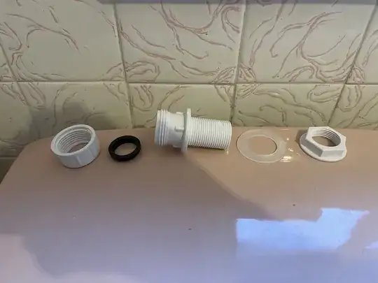

The first thing I tried was to buy a McAlpine R4M straight tank connector which has a backnut (on a 3/4" thread) to secure it in the tank hole and a compression fitting to connect to the pipe. However the threaded part must be inserted from the outside and there is no room to get it past the end of the pipe. The pipe wiggles a bit, but nowhere near enough. Even if this were possible, I'm not sure the insertion depth of the pipe would be enough to make a good connection. Here are the parts of that component, laid out in the direction they would be fitted:
Exploded arrangement of McAlpine R4M tank connector

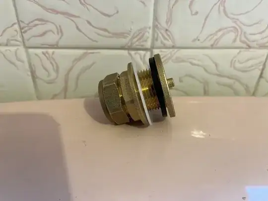

I then bought a "35mm compression tank connector" similar to this one. This has the right compression fitting and it is meant to go into the hole from inside the tank, but the thread is too wide to get through the hole (I'm guessing it's a 1" BSP thread). And even if it did fit, I think it has the same "reach" problem to get to the pipe.
Brass 35mm compression connector
