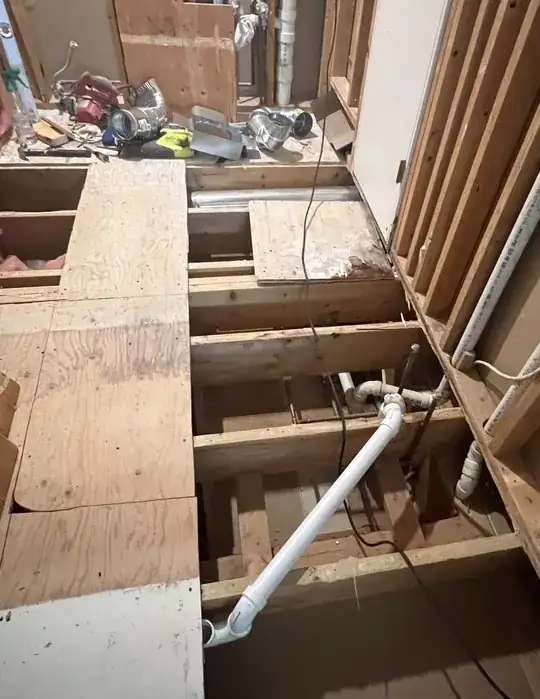

In my area code allows me to keep my 1 1/2 inch drain for new shower which I thought would save a lot to not have to cut out the stack and replace the wye to the toilet and present bathtub drain etc. having a dedicated vent only 28 inches away from the new shower drain makes even the extended 1 1/2 inch drain work. Funny I had 2 plan review guys at RBD say I could not use a reducer on the drop pipe since most of the tiling pans have 2 inch pipe, but finally the chief inspector came over and said no problem. However I have recently seen a reamer that would allow me to ream out the 3 inch stack coupling that currently has a 3 to 1 1/2 inch adapter, and since I already have most of the subfloor up anyway to replace water damage and move a floor heater duct into the wall etc, another 2 feet (where the tools are) would not be a huge deal if they work as intended. Would it be an advantage to increasing to a 2 inch drain and can I expect the reamer to do what it’s supposed to so I am not stuck with cutting out the stack? Showing the new extension which of course will be installed below the joists. enter image description here
