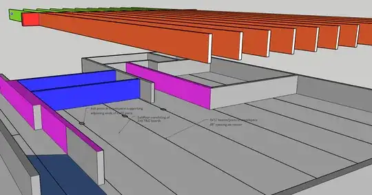

The main level floor beam with the sag (shown in red) consists of a 4x12 sistered to a 2x12 and is currently only supported in the basement by the purple walls. This beam supports the main level floor joists (2x12s, 16" spacing on center) in both directions with face-mounted joist hangers which are nailed to the beam but not the joists. As a result, the sag in the red beam has allowed the orange joists to also sag at this end since they are only supported at the opposite end by the exterior wall. But the green joists are held rigid by the blue walls, which is causing a significant and sudden dip in the floor as it moves from the end of the green joists to the sag of the red beam and orange joists.
I am assuming that I should position the post over one of the 4x12 joists in the crawlspace, but will it require a post directly beneath it in the crawlspace? Also, can the post go directly onto the basement's 2x6 floorboards, or will it need some additional base or footing?
diagram of beams and support boards
