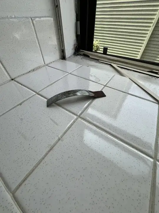

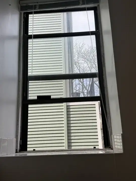

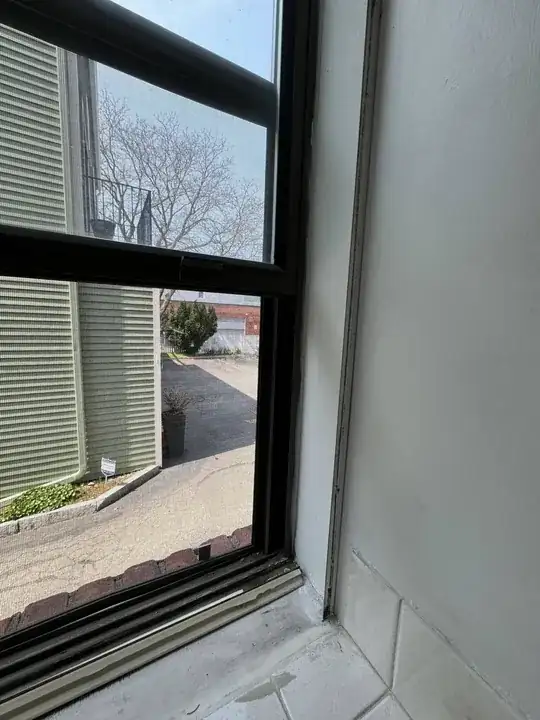

Today, we opened one of the windows for the first time, because we needed to air out the bathroom after using some volatile chemicals. The window got stuck open. I couldn't close it, so my partner tried to muscle it closed. We heard a snap, and what looks like a metal band or strap, rusted on one end, fell out of the window on the right side. Now the window is stuck open 2/3 of the way. It will not budge. I've attached photos.
This is on the first floor of my condo, facing the street, so I feel uncomfortable just having it open like this. Is there anything I can do to fix this to get it closed? We can't really afford to replace the window right now, but if that's the only option, we'll have to make it work.

That part's function is to push the window to one side of the frame, to prevent it getting wedged.
What you have is just a wedged window.
Try to loosen it by pushing up, but only on one side at a time.
When closing, push the window to left or right side simultaneously to prevent wedging.
