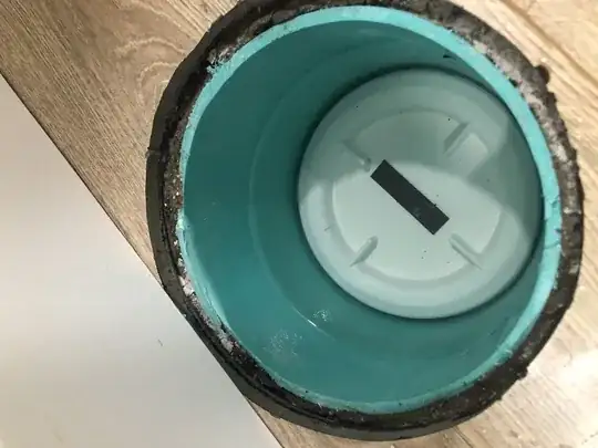

All that leading to my real question, I found water above the seal to the back flow preventer in the small pit. I’m wondering if this is bad or normal? I twisted off the seal to release that water into the pipe, but it quickly fills back up when I put the seal back on.
backflow preventer in bathroom, above seal filled with water backflow preventer in bathroom, above seal filled with water

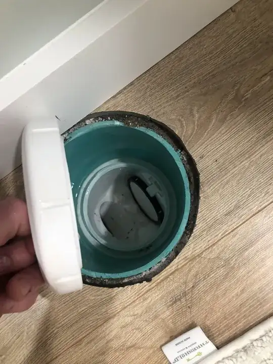

seal removed to drain water from pit seal removed to drain water from pit

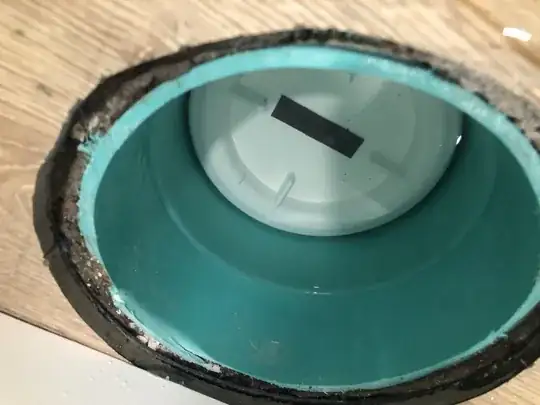

water fills back up quickly after putting the seal back water fills back up quickly after putting the seal back

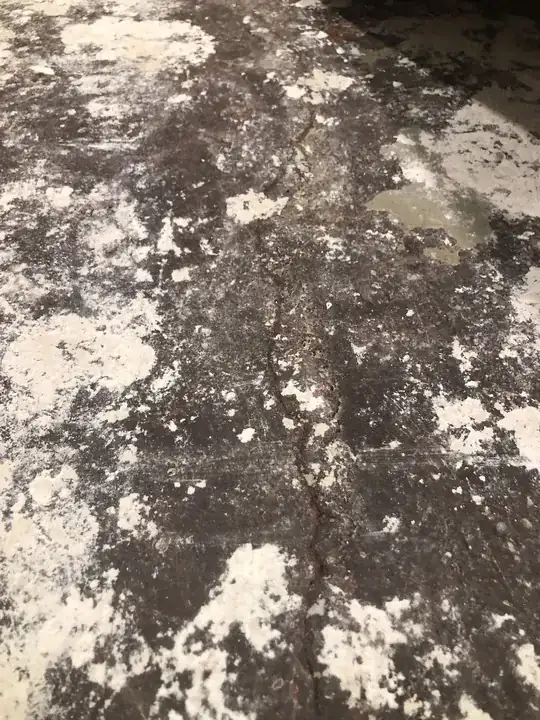

crack in the floor seeping water. This is adjacent to the bathroom with the backflow preventer crack in the floor seeping water. This is adjacent to the bathroom with the backflow preventer

It has nothing to do with the backflow preventer, evidently. The hole in the floor is acting as a small sump pit with no pump.
So, the whole floor is wet, and water is flowing into the low spot. You'll find out if the flooring is really waterproof, or not.
You either need an actual sump pit with a pump, or exterior grading and perhaps also drains, or some method of reducing the ground water level at the house to below the floor. With a house already built, grading can help, but the sump pit (or more than one sump pit) is generally the most affordable approach other than just correcting the grade to slope away from the house for 10-12 feet. If you already have a sump with pump, it's not deep enough or not close enough to this part of the basement floor. Adding gutters or extending downspouts to get roof water away from the house can also be helpful.
