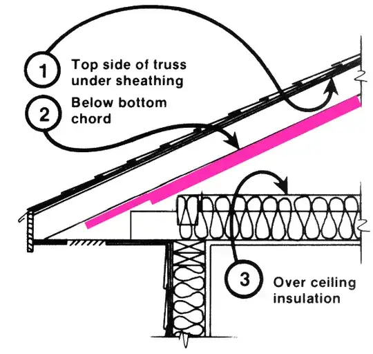

My understanding is that moisture becomes the biggest concern when making the retrofit (that and it's an attic half filled with junk). Spray on foams seem to be the standard solution to this, but I wanted ask a question so I understood the issue with obvious/easy first thought, why not just screw in polyiso to the interior side of the rafters/bottom of the chord: Simple schematic of polyiso rafters
Meaning the pink layer in the drawing, and would have ~4in of dead space before the board. I'm assuming this would cause condensation to form around the trusses (exterior to the polyiso), leading to rot? And then any gaps or venting sufficient to prevent the condensation are probably going to require enough air exchange that the value of insulating is largely mitigated?
I note there are also no insulation baffles, and part of me wonders if it wouldn't be possible to intentional condensate moisture (on a small pipe or large exposed wire for example) and have it drain out the soffit? Presumably even if such a system would help, it wouldn't be perfect, and there would still be rot risk, just over a longer period.

It should be noted this is perhaps not making a true unvented attic, but instead just expanding the size of the insulated space, such that the rafter cavities are where the ventilation occurs.
This still brings up my concern on moisture, where the question would be: if the ventilation is only at the soffit and ridge vent, will that be enough circulation to avoid a condensation issue? Presumably would also be concern that the insulation was provided with double polyiso boards with non-overlapping seams? The distance along the rafter cavities is ~7.1m/23.3ft. Would such a plan require something like a fan at the ridge side to encourage airflow?

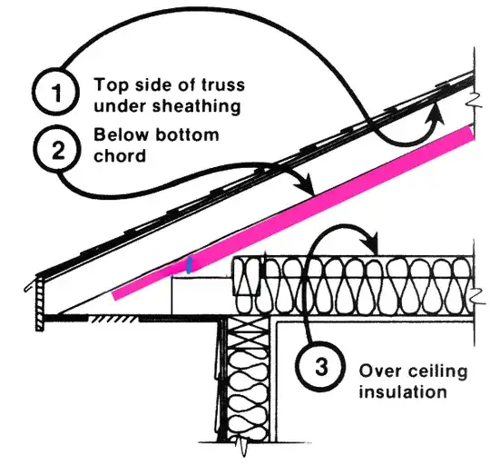

That said, I will say that in your drawing the poly is very possibly too low. That may impede airflow to the main area of the attic. That should not happen. Blocking air flow and completely sealing off the attic could result in damage from trapped moisture. (Something you don't want.)
The attached drawing shows a blue line where the poly should end before blocking airflow. Of course this should be modified in the field to achieve the result of unrestricted air flow.
