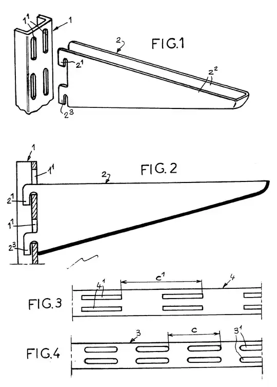

Picture1 of the other parts (not sure how you call them):
1 Image from: http://patentimages.storage.googleapis.com/EP0404699B1/imgf0001.png

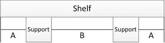

Edit: as the original poster and Henry Jackson suggested, the Sagulator cannot help directly with optimizing the position of the supports for the shelf - it only calculates the sag of a given length of shelf, and cannot provide the sag for a shelf that is only supported at one end. In the following diagram, the Sagulator can help with determining B, but not with determining A:
Shelf diagram
This is due to the mechanical formula used by the Sagulator. Searching a little through the reference provided by the Sagulator, we can see that the actual formula used (for uniform load with the shelf fixed to the supports) is this: Structural Beam Bending Stress & Deflection Equations / Calculation - Fixed at Both Ends with Uniform Loading. Indeed, punching the numbers gives the same result, if the Sagulator "Apply WoodBin lab correction?" is not checked - i.e. only the mechanical formula is used (based only on the dimensions and the properties of the wood).
This is all well and good, but what about dimension A for the shelf? Here comes the following formula: Structural Beam Bending Stress & Deflection Equations / Calculation - Cantilevered Beam with Uniform Load. This is the formula for measuring the maximal deflection at A. Comparing the two formulas ("Critical Deflection" in the first vs "Deflection at the unsupported end" in the second), one notices that the calculation is the same (Wl^3 / x EI) except for the fixed denominator x - 384 in the first formula and 8 in the second. This would mean that the maximal deflection for the unsupported end would be 384 / 8 = 48 times greater than the maximal deflection for the shelf supported at both ends. So, if you have a figure of 100 KG for a supported shelf span (B) of 96 CM, the maximal length of the unsupported shelf (A) that will still be able to support 100 KG is 2 CM (96 / 48 = 2).

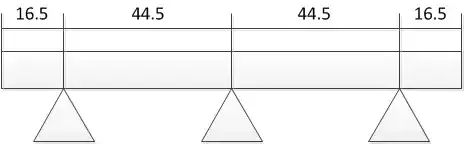

Naturally a 2 CM shelf won't need to support 100 KG. Here some tinkering is required to get meaningful results. Using the 122 CM shelf and ignoring the width of the supports, to support a total load of 60 KG (typical for a 122 CM bookshelf fully loaded with books), we'll get about 0.5 KG per 1 CM. A span of 16.5 CM with a load of 8.25 KG will give a sag of 0.01 MM per running foot. Converting this to a shelf supported only on one end by multiplying by 48 gives us 0.48 MM per running foot, as suggested by the Sagulator for a maximal deflection visible by the human eye (0.51 MM per running foot). This will leave us with a supported shelf span of 89 CM (122 - (16.5 * 2)). This supported span can't support the needed load of 43.5 KG (60 - (8.25 * 2)). Adding a third support at the middle of the supported shelf gives us two spans of 44.5 CM, each easily carrying the 21.75 KG load:
122 CM shelf supports
