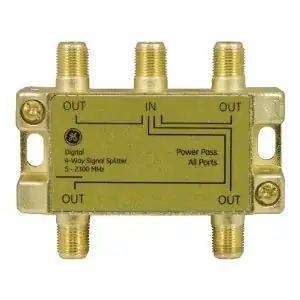

I'm planning to re-arrange some coax cable lines in my house which will effectively require me to connect them to a 4-way splitter.
alt text
The wifey would prefer these connections to take place in a discrete location outside of the house. My concern is that issues may arise later from the connections being susceptible to outside weather.
Is there a special enclosure I could put this in to protect it? Or is the only option to just connect the junction in a dry indoor location (e.g. attic, crawlspace, etc).

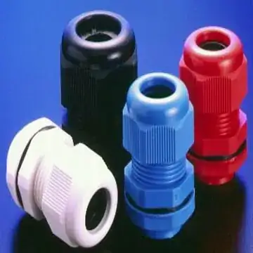

If you have to locate the splitter in a location where it is more directly exposed to the elements (eg, not underneath a soffit or something), you might want to get a PVC box, and then put waterproof box connectors on it, which have a gasket that seals around any kind of wire. This will provide the best waterproofing.
