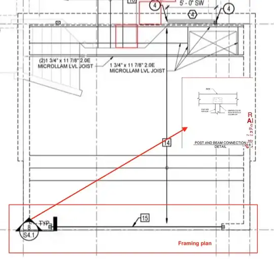

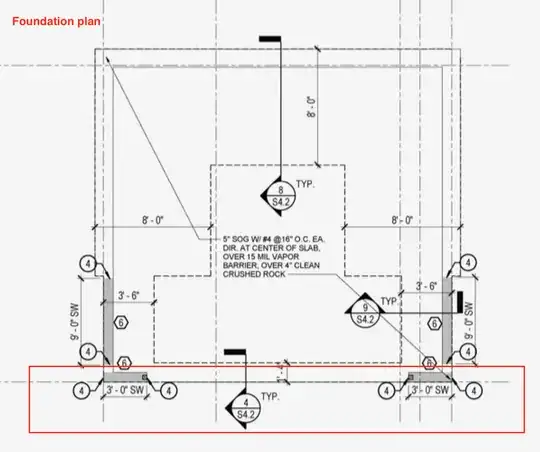

I’m having trouble interpreting the plans for the garage entrance. A detail of a post beam hardware is throwing me off.
The garage wall is flanked on either end with 3-0 shear walls as detailed in the foundation plan. However the framing plan calls out a post / beam connection hardware (simpson ECCQ/similar), so should I frame this as a portal frame with straps? or something else. The beam for the garage door is a regular 4×12 DF. and ceiling height is 11-6.
Foundation plan
Framing plan
