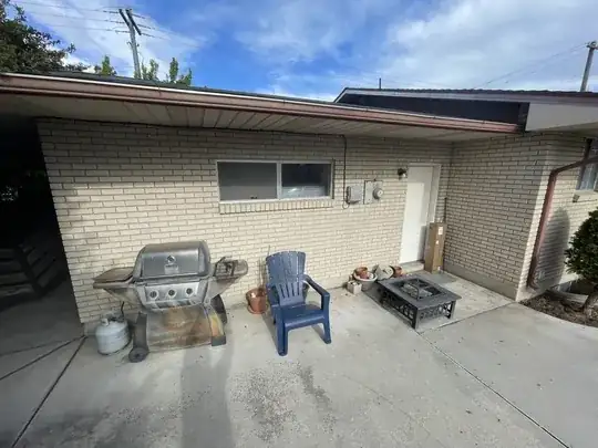

I'm wanting to do a basement walkout for our rambler (Orem, Utah). Here's the steps I have so far:
  • Move service panel to the left of the photo
  • Use concrete saw to cut out line 58" from back of garage
  • board up rear door to garage
  • Call blue stakes (again) to double mark power lines
  • Dig out concrete & dirt with mini-excavater
  • Cut door out of basement foundation (concrete, rebar)
  • install door, cement steps out.
Caveats:
  • I'm not exactly sure where the footing is for the garage concrete, it could be 3' or 8' down. Even if it's in the way I'll still be able to cut a 40" opening (58" - 8" footing - 9" foundation wall).
  • the current 100A power conduit is smack in the way but since the power company is making me replace it to upgrade I'm going to move it as well.
Questions:
  • When and where do I take my plans to the city?
  • How much of this work can I get done before it's approved by the city?
  • Is it even worth getting started before plans are approved?
  • Any additional tips from pros is very appreciated
*photo of back of garage (west) connected to house (right) Back of garage

I'm reading the above as "the steps I have identified so far." Also I have the understanding that the door into the basement will be in (below) the section of wall to the right of the garage door, ie between that door and the brown down spout. The stairs would rise upward and to the left, parallel to the rear of the garage, with the top-most step in the vicinity of the BBQ/propane tank.

If the basement is deep enough you could retain the entry door to the garage. Pour a bit of concrete or frame some wood to create a garage-level walkway crossing over the basement stair landing. Looking at the level of the window in the adjacent window well, though, it looks like the basement is somewhat shallow and this may not be possible.
The brick facade rests on the foundation concrete. It's likely you'll need to devise a plan for supporting the brick when the foundation beneath it is cut away.
