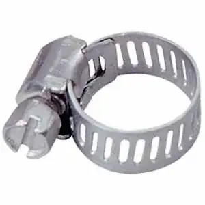

As a temporary measure I used a metal hose clamp to run a bare #12 copper wire between the box ground screw and a nearby EMT conduit that was already grounded. The wire is never getting out, it is cinched under the clamp quite hard.

What I used (at least temporarily):
hose clamp
[ image source ]

There's the Code answer, and the practical one:
Start from NEC 110.2:
The conductors and equipment required or permitted by this Code shall be acceptable only if approved.
Approved means listed and often means labeled. If the hose clamp has a listing number, it meets that bar.
Then add in NEC 110.8:
Only wiring methods recognized as suitable are included in this Code. The recognized methods of wiring shall be permitted to be installed in any type of building or occupancy, except as otherwise provided in this Code.
If you find a Code section that allows you to clamp the wire directly to EMT with a hose clamp, that would be an approved method.
Most likely your hose clamp is not listed, and I'm not familiar with any Code provision that allows use of a hose clamp for grounding.
Now, the practical answer: if it's genuinely solid this will probably be fine. Hopefully the clamp doesn't corrode, the wire against the conduit doesn't end up with high resistance due to the interaction between the metals, and if it does you never need the ground. That's a lot of items which need to line up.
Personally, it would lead me to pick up one of the right clamps the next time I'm getting other electrical supplies, then replace my hack with the right item. In fact, I did exactly this with a ground wire last year. I used a hose clamp on it to get things up and going, then bought a clamp like the one in your picture and swapped it out a few days later.

To give a bit on insight, electrical connections are degraded by oxidation of the conductors. If two bare metal conductors have a good, low-resistance connection at first, the resistance between the two will get higher as air causes the conductors to corrode.
The most common way to prevent this corrosion is to have high-pressure contact between the two conductors. If the pressure between the two conductors is greater than air pressure, air can't get in between and cause oxidation.
The ground clamp has teeth that will cause an air-free connection to the pipe when the screws are tightened sufficiently. Likewise, the screw connection to the conductor will create an air-free connection when tightened sufficiently. This creates a long-lasting corrosion-free bond between the pipe and the wire.
A hose clamp cannot create enough pressure between the wire and the pipe to prevent corrosion forming in the interface between the two.
Go with the safe route. Install a proper ground clamp.

Sheet metal style strap clamps are allowed in NEC. Just not for what you are doing. Communications grounds for TV or satellite or telephone can use a listed version per 250.70(B). A non-listed hose clamp isn't enough though.
For outlets and other devices NEC 250.8(A) requires a few types of connections. Retrofitting is per 2014 or newer under NEC 250.130(C) allowing to connect to grounded emt.
Code limits you on how you can connect the equipment grounding conductor. You can weld it, you can use a terminal bar, screw/nut with atleast 3 threads or you have to use a listed device (meaning certified by a agency that your local inspector approves of). A hose clamp wasn't tested for electrical conductivity. Even though you know it works, I know it works, everybody knows it works, the manufacturer isn't interested in risking themselves to say it works.
Frankly, reading this you can drill a hole in your emt and use a self tapping machine screw and that would be enough. But just do it at a junction box instead to not get side eyed.
Or do what you already know, get a listed, designed for electrical grounding pipe clamp.
