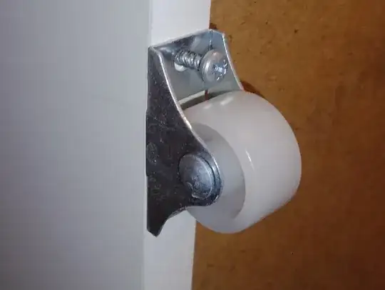

This is from the bottom of a Malm (I think) bottom drawer. The edge is the same 17-18mm you've got, and chipboard. I've backed out one of the screws to show you the relative size. Note that if you go down this route you should use a pilot hole a little longer than the screw (and a fairly tight one at that) and do the screw up by hand stopping when it feels like the head has firmly contacted the bracket. Driving it in with power tools is far too likely to ruin the hole. This has held pretty well, on carpet, and if it starts to loosen you can fill the hole with epoxy and re-drill it. But in the case of drawers it's unlikely that someone will deliberately or accidentally try to move it sideways.
Ikea Malm wheel
These non-castering wheels exert less leverage on the screws than casters (which are always taller), and the direction of forces on the pair of screws is less likely to cause damage than it would be at right angles.
