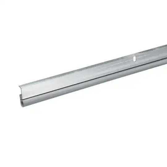

There are styles of weatherstripping that attach to the door stops, and the position is adjusted such that it just meets the door to provide the necessary seal.
Here is an example of Frost King from Home Depot, but there are probably other manufacturers that make this same style.
