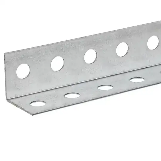

Supporting the countertop can be achieved by installing a long angle against the wall and under the countertop. Be sure that it is secured to studs (you should be able to hit two in your location). You can buy angle with holes already in it like this example:
