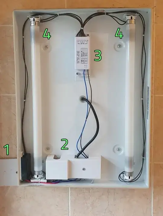

The mirror innards:
photo of mirror innards
Annotations:
  1. wall plate for power cable
  2. plastic housing for terminal block, switch and what looks like a transformer (?)
  3. ballast device
  4. T8 fluorescent tubes (2x)
There's also a shaver plug on the side of the mounting -- black box lower left -- which isn't part of the lighting equation (I think!).

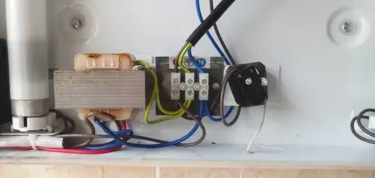

Detail for 2:
transformer, terminal block, switch
Left to right: transformer (?), terminal block, switch

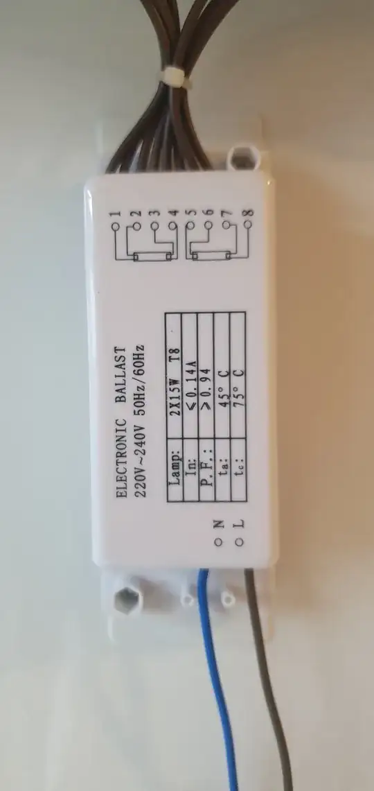

Detail for 3:
ballast

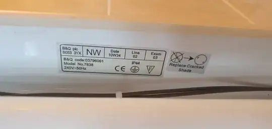

Finally, the product sticker:
mirror product sticker
Searching for these product codes on B&Q's website yields no results.
I have tried testing for voltage with a non-contact tester (from 1 to 2) and the tester illuminates, so the supply seems to be good. I also checked the live and neutral wires leading to the ballast, which produce a result when the switch is operated, however the brown wires coming from the ballast do not cause the non-contact tester to light up. Finally, I have visually inspected for obvious defects (eg a wire that has wiggled free from a terminal block) but there's nothing that I can see which is clearly wrong to my eyes.
I haven't tried new tubes as I thought the chance of both failing at once was less likely, given other symptoms. I'm on quite a tight budget so I'd prefer to avoid the "troubleshoot by replacement" approach if possible!
Is there further troubleshooting I can do? I am wondering if the result with the non-contact voltage detector and the pre-failure symptoms suggest a faulty ballast. If so, is there a way I can definitively confirm this?
