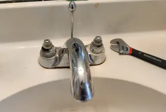

Here's a picture of the faucet with the handles removed:

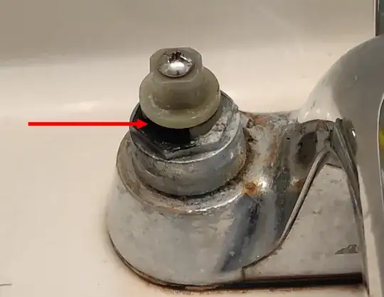

And here is exactly where the leak is coming from when the taps are turned on:

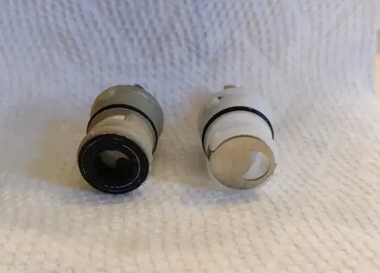

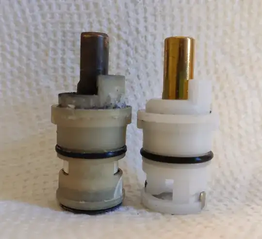

And here are the old and new cartridges,
The new cartridge is Moen OEM part M0005, labelled as a replacement cartridge for Glacier Bay, Eurostream, and Danze. As you can see, they're similar but not identical. E.g. the old one has a washer at the bottom, while the new one has that metal part. But I they're very similar looking and I didn't see a variety of Glacier Bay replacement cartridges so I assumed this was the right part.
When I install the new cartridge and turn on the shut off valve, the cartridge lifts up about 1mm and water starts rapidly seeping out around it.
If you look closely at the side view you can see they're slightly different heights.
Did I buy the wrong replacement cartridge? If so, is there a different Glacier Bay bathroom faucet cartridge I can guy. Does anyone know the manufacturer part number?

Your faucet is worn or corroded inside where the O-ring is supposed to seal the cartridge to the faucet body.
You can try to use some fine emery cloth to clean the cartridge receptacle. However you are probably looking at purchasing a new faucet assembly.

"The hot tap leaks water around the base..." Since it's not from the faucet, and it leaks, "when either tap is turned on," then the leak is inside the faucet, between the point where the hot and cold water mix and the outlet.
It appears it might be possible to remove the panel at the front; if so, look for a pipe or connection with a pinhole leak.
However, fixing such a leak may be difficult or unfeasible. If the water is acidic, and has corroded a pipe causing that leak, then after patching, it would soon leak elsewhere.
Perhaps the easiest and most cost-effective fix would be replacing the entire faucet.
