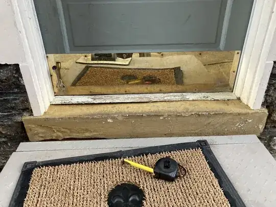

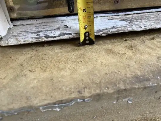

The sandstone doorsill below the wooden threshold is eroding at the side door of my 1890 wood frame Victorian home. The stone face has begun to spall. I want to fill the gap to keep out water and critters, and retard further erosion.
Two parts to the question:
1. What should I use to fill the gap?
2. What should I do to preserve the sandstone?
The protocols I have found for repairing sandstone were written with brownstones and other historically significant structures in mind. They prescribe very time consuming and expensive procedures, involving drilling holes and cementing anchors in them, removing at least 1/2" of the surface (because the patching mix may fail if it's thinner), undercutting the surface with a thin diamond blade to hold the patch, drilling holes and cementing in anchor pins, and finally color matching the special sandstone cement mix. Portland cement and other commonly used patching compounds are eschewed because they are too hard or not permeable enough to allow moisture to escape, accelerating further deterioration.
The house has only the one sandstone sill; it's on the side of the house where it's not prominent. Historic preservation is not a requirement. It's not a major architectural feature. Still, I would like to keep it. Yet I'm balking at the amount of work required to do it as one would to keep an historic brownstone up to snuff. In short, I'm looking for a way to fill the gap to keep critters and water out, provide support for the threshold, and retard, if not prevent, further erosion.
Ideas I have considered: To fill the gap, foam caulk would seal well and be easy to apply, but provide little support for the threshold, which will get stepped on. Clear sealants (such as silicone, clear rubber coatings, and clear acrylic paint) would keep moisture out - but also in. Maybe coat the top and face, but leave the bottom open to breath?
Recommendations please!

There are numerous high strength leveling mortars available to reprofile your sandstone, the process requires you to remove all loose sandstone, seal with an adhesion promoter/sealer following which reprofile with a mortar to suit thickness. Replace the threshold by drill and fix onto a large bead of good quality silicone sealant which will prevent water ingress. There will be a colour variation which can be addressed by painting...
