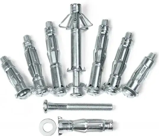

I don't have any real concerns here. Consider a sleeve-type toggle rather than the bulky winged type to keep the holes you have to drill small. One additional benefit is that you can remove the screw after installation without the back portion dropping into the abyss. Make sure you select one with the proper sleeve depth.
I agree with everything in the other answer from isherwood, ie, you can definitely do this, your worries are unfounded, and with the right toggle bolts you'll do great. I'm suggesting an alternative fastener that I think is easier, especially for DIY: Sheet metal screws.
If you use the right ones and use them correctly, they will perform extremely well, they are easier to learn, harder to screw up, and much cheaper. You avoid interference as noted with screws from the other side. You also avoid a more likely and annoying problem: If your toggles aren't centered on the stud, the sides of the stud may interfere with them spreading properly. And if you don't have the knack for it, they end up just grinding huge holes in the drywall and never getting tight enough. IMO with a very small amount of practice, someone with little experience can get sheet metal screws right every time.
