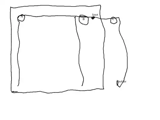

Would need three pulleys, a short and long cord and a hook/boat thingy/holder to hold the cord.
Attach the long cord to the short cord before pulley B. Pulley A will be at the far end of the blinds, so long cord goes to the bottom. Pulley B is at the near end, and pulley C is on the wall, so the cord will go down to the cord holder.
It is bad I know, but hope you can make sense of it. I will not give up my day job to become an artist.

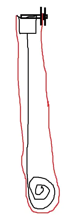

sketch front view added ropes and pulleys sketch side view added ropes and pulleys

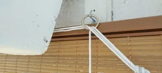

Where the diagram specifies "pulleys", I opted to use simple steel rings. They're about a quarter the price, and also make it easy to run multiple cords through them in slightly different directions, which is handy since the blinds actually use three hangers and hence I used three cords. Closeup of cords through ring

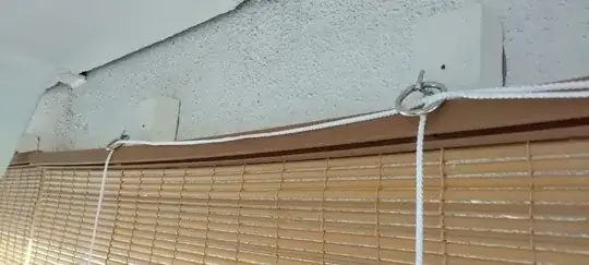

Overview of cords and rings
I didn't feel like measuring out and cords to cut them (though it ends up being about 20-24' each, depending which end of the blind you're connecting to), and the blinds were already hung and kind of a PITA to take down, so I ran the cord through "in reverse" and then tied them to the anchors behind the blind. This was a little ticklish, since I don't have easy access to the back, but worked OK.

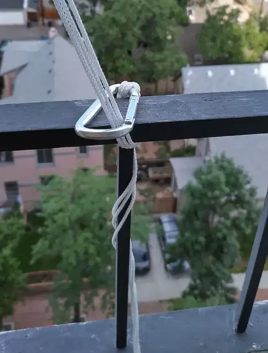

I've tried a few wraps around the railing and then a slip knot carabinered to the line to keep it from coming out. enter image description here

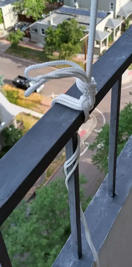

And also a mule hitch with an overhand backup. enter image description here
