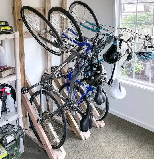

You can store bicycles vertically with the rear wheel resting on the ground:
  • You don't need to lift the bike to hang it
  • The fastener doesn't need to hold the full weight of the bike, only prevent it from falling over
  • Most of the weight rests on the floor, not hung on the shelf
Here's an example:

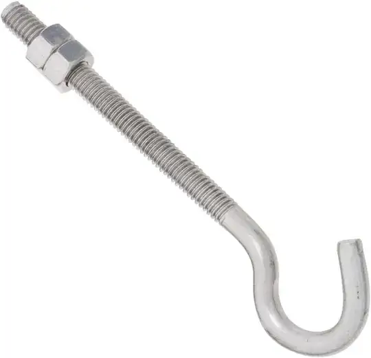

You would use screw/bolt eyes (or hooks) with a machine thread, two flat washers, and two nuts. Thread a nut and washer onto the bolt, insert up through the hole you've drilled in the shelf, top with the other washer and nut, and tighten the nuts to squeeze the shelf. Some hooks have spring clips on the hook as well. The larger the washer, the more weight the wood can sustain; fender washers are larger and will hold plenty on a sound 1" board. The projection above the shelf need be no higher than the thickness of the bolt plus washer, so you lose little if any storage space.
(screw hook)

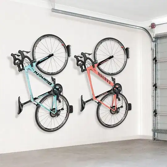

A swivel wall mount like this will hold over 66 lbs or 30 kg, is ready-made and easy to install, and will pivot to allow the bike to rest closer to the wall. You need not mount the bike with the rear wheel up off the floor as in the pic; I wouldn't want to lift it up there. (swivel mount)

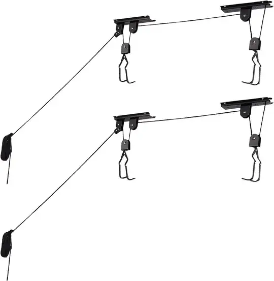

A bike hoist is a very elegant yet inexpensive solution that will screw directly to your shelf. (bike hoist)
Its pulleys give a mechanical advantage of 4:1, so a 70 lb bike needs only an 18 lb pull, and it's pulling downward instead of lifting upward. The two brackets attach to the wood with eight included wood screws (providing plenty of redundancy). The rope lock holds the weight after each pull as you lift it, and stops the bike's descent if you let go.
