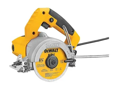

The other answers are good workarounds, but do you know they make actual portable wet saws for this? For example:
It even includes a water line that you connect to a small pump.
The problem with trying to do this dry is the huge amount of dust, which is not just a nuisance, but very unhealthy.
You can use a straight board and clamps as a guide. Just go slow and/or do the work in several passes. Make sure to support the piece well, so that it does not drop/crack as you weaken it with each pass.
