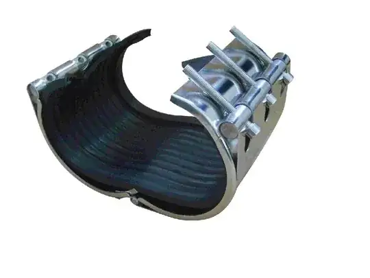

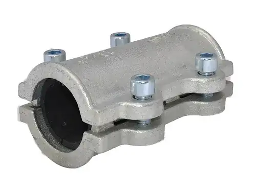

Pipe Repair Clamp
http://www.lowes.com/pd_24521-143-PP24001_0__
There are quite a few different styles; however, almost all of them are designed for metal pipes. Personally, with PVC I still suggest replace a section of the pipe, but if you can't this will get by in a pinch.
Make sure to prepare the surface. Turn the water supply off, sand the area (get rid of your epoxies and rough up the surface). For a good seal, I'd add some 100% silicone "caulking". then put the clamp on. The clamps come with a rubber gasket and if you are using a universal size one then be extra careful not to crack the pipe, it takes a bit but is surprisingly easy when using tools. Allow a couple of hours for the silicone to dry (most dry times listed are expecting surface air to help dry/cure it so if you can manage it leave it overnight)

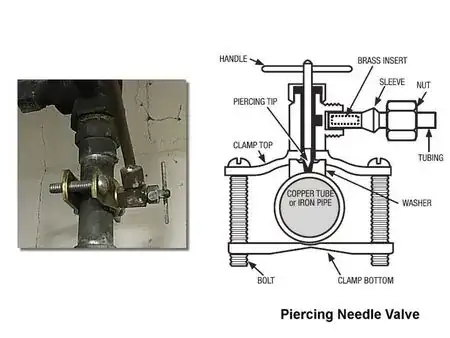

By using a self-tapping shutoff valve you can place the the nail of valve off in the pinhole and tighten the clamp down.
