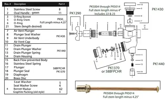

There are a few washers/o-rings shown in the exploded part diagram:
If the drip never stops, there must be water getting past the valve. Item 6, the o-ring located at the end of the stem looks to be the main seal. Remove the handle and then the stem and take the o-ring to a local hardware store and see if you can find a matching one.
If you cannot find a matching one, you can order the replacement Stem Rebuild Kit PK1000.
If the drip eventually stops but takes a long time, it could be residual water left inside the valve taking a long time to drain, especially if the valve is not sloped down towards the drain port.
Refer to the image on page 3 of the manufacturer's documentation shown here.
If the drip occurs while in use, it would be the washer noted as item 12.
If you cannot find a matching one, you may be able to order the replacement part PK1440 however the manufacture says they no longer make it.
I have no affiliation with that site, it was the first site I found with those parts.
