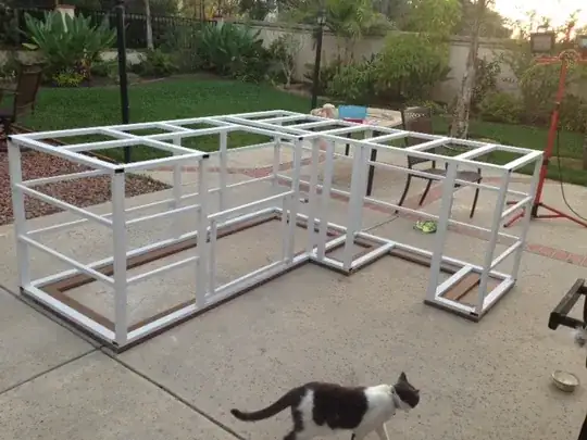

So I've built a metal frame that is going to be used as my outdoor bbq. I am ready to install siding on it and I was told to use HardiBacker.
I googled it and apparently it isn't for use outdoors. What is a good cement board or other material that I can use as the sidings for my bbq?
It is on the edge of a patio and lawn so the sprinklers WILL get it wet about every other day. I am open to other suggestions
