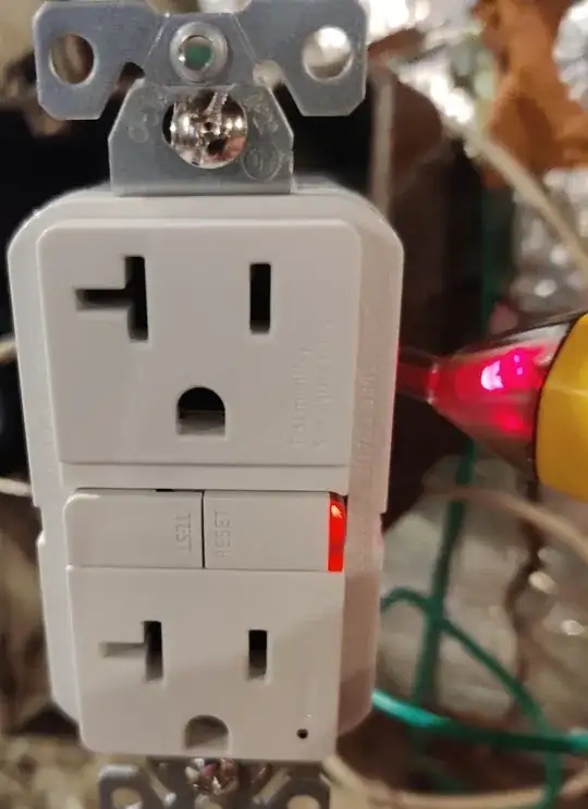

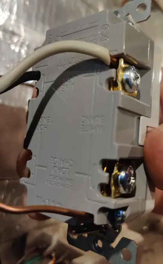

Picture of the back of the GFCI causing issues.
receptacle-back

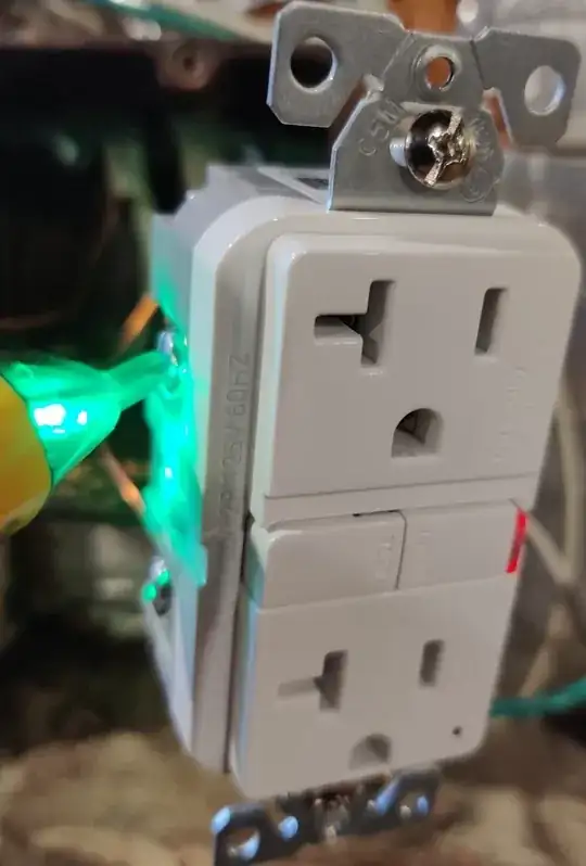

Picture of the front of the GFCI causing issues.
receptacle-front-1
receptacle-front-2

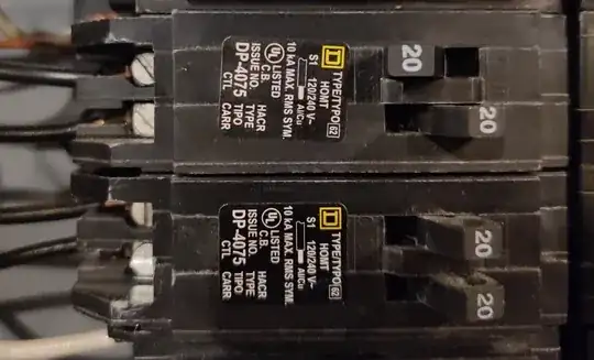

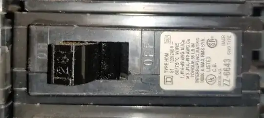

Picture of the breaker that the GFCI is connected to. It's the one that is flipped off.
receptacle-breaker

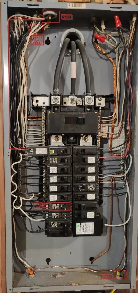

Overview of the panel wiring with the two working GFCIs marked with red boxes, and the problem GFCI marked in another red box (sorry for fuzzy text).
panel-overview-details

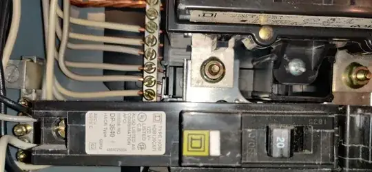

Picture of one of the breakers that has a working GFCI receptacle.
working-GFCI-breaker-1
