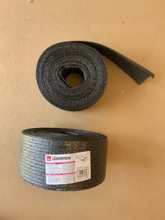

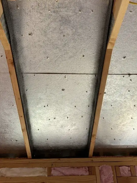

As an alternative, I'm thinking to use rolls of sill gasket foam (e.g., Propink ComfortSeal) and just staple that up to help friction fit and seal around the edges of the polyiso. If I use a 5.5" wide sill gasket folded in half, it will fit nicely inside the rafters and nominally give me up to 3/8" of compressible foam on either side of the rigid foam board.
Do you foresee any problems with such an approach? If so, what other options are there?
Here is a photo of what I have in mind (2.5" rigid foam board will then go in flush with the bottom of the rafters leaving a 1" ventilated gap along the bottom of the reflective roof material): sample install sill gasket material
