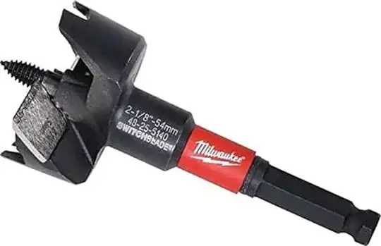

You need a forstner bit of the correct diameter like this (I have no interest in this brand, it's just the first one that popped up in a search for an image): forstner bit

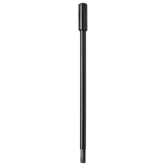

and drill extensions like this with a total length that adds up to the depth you need (You may need more than one): enter image description here
and since these are large diameter bits, they have shanks and torque requirements that require a drill with a 1/2" chuck, which is bigger than the average homeowner owns.
