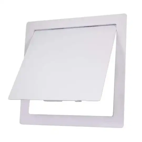

I did almost the same thing to the 90s home I moved into a while back--the CRT to flat TV conversion with a new forward wall. In your case, it may make sense to put an access panel behind the TV so you can simply run the cord through to the original outlet.
These tend to have knockout notches near the edges so you can easily make passthroughs for cabling. Or make your own with a Dremel or drill. They're paintable, so consider a spray job before installation or roll them to match the wall.
I actually used smaller grommets because I'm able to reach under the forward wall. That may also make sense.
image source
