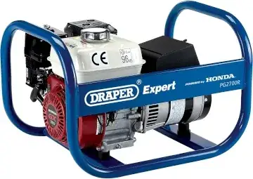

Inverters on their own require allot of battery power (like Tim explained) An alternative solution that might cost less or the same but with much better outcome is getting a small petrol or diesel generator.
The benefits are they can pump out a constant wattage as long as you got fuel. If your batteries die out and there is still no electricity - you can't charge them.
Another advantage is that you can pull some wire and place a separate emergency socket in your house and get some lights going, keep the fridge from defrosting, watch tv? or whatever else.
Disadvantage is that the normal sized generator can be loud and need to be hooked into an exhaust if used in doors, like a basement or loft. But you can buy slightly more expensive silent generators that offer the same power but when they run you can hardly hear them and are much smaller.
It all depends on how much power the sump pump needs and any other uses you could use it for.
