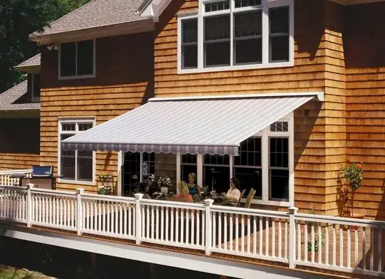

The cheapest and easiest way to stop the sun hitting a window is to add a roller awning.
Note that they don't actually need to stick out all that far in summer, when the sun is high in the sky. There's much less chance of it being damaged on a windy day if you roll it out just far enough that the window is in shadow.
stock photo

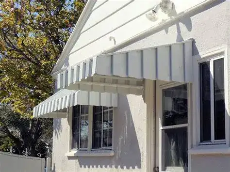

Fixed awnings were common in many parts of the US before air conditioning was available, and are still seen on older houses. They can be a bit more expensive to install but should last longer.
Fixed metal awning

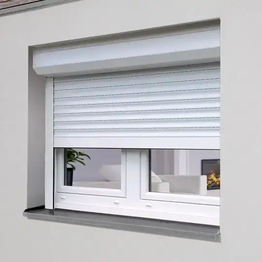

In France these are popular, we call them "roll curtains":
However, IMO they suck. That's because a window performs many different functions: look outside, let in light, ventilation, let in or block heat/cold, block intruders, etc. And with a rolling curtain, either it's down and you're in the dark with no view and no ventilation (but not thieves either), or you roll it up and it does nothing. But if you want to leave the window open at night in the summer to let in the cool breeze, then you have to roll it up, so there's no security. Plus they're ugly and when closed the space between the shutter and the window gets extremely hot when the sun hits it, so not very effective against heat either.

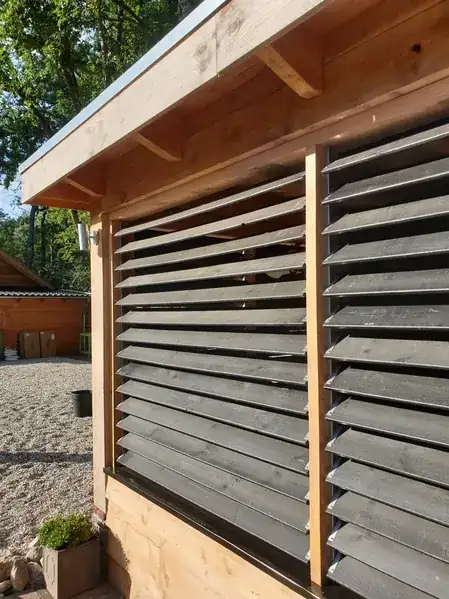

Louvred shutters look better and are much more effective. They provide ventilation when closed, provide some security, and you can open one or the other, or leave them ajar, to block direct sun depending on the direction it's coming from.

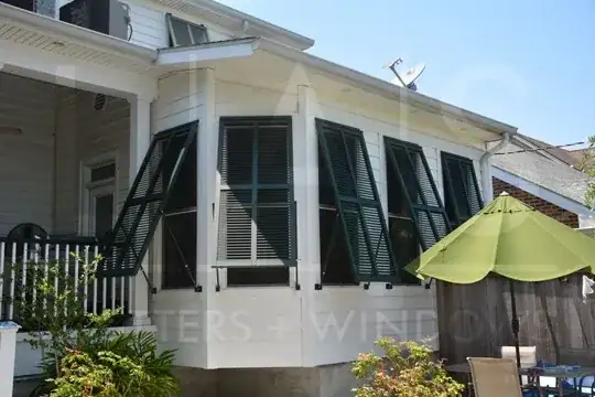

You could also consider the historic type of "plantation shutters" still used in places like New Orleans. These are installed (as other posters have mentioned) outside, and typically hinge at the top, with slats to allow air circulation that are angled to keep the sun out in the summer and allow it in during the winter (when the sun is lower). Another advantage is that they can be lowered to physically protect the window during periods of high winds.
Here's a photo from a contractor in New Orleans (LAS Home - lashome.com, with whom I have no affiliation): Photo of shutters in New Orleans
