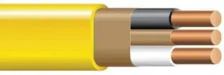

Nonmetallic-Sheathed Cable
Romex is covered by article 334 Nonmetallic-Sheathed Cable: Types NM, NMC, and NMS.
NM Cable Assembly
Nonmetallic Extensions

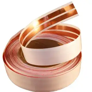

Article 382 covers a cable known as FlatWire, or Concealable Nonmetallic Extension (CNE) cable.
FlatWire
Notice that this cable has a single insulation layer over the conductors. Whereas NM cable has insulation on the conductors, and an outer insulated sheath.
