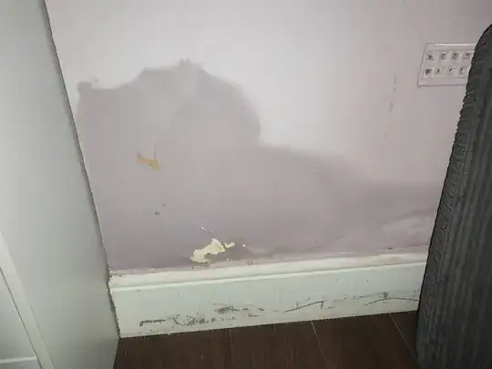

In this bedroom there is a chimney breast. There is always a large patch of damp when on the bottom left. It can be seen in front of the chimney breast and also the side. In the winter this patch expands to cover almost all of the bottom of the chimney breast. In the summer it contracts to what we see here.
We had the top of the chimney sealed so no rain and fall in. We also use hot air heater to make it go away but it stays.
I want to know if there someway to cover this part of the wall such that the patch is pushed behind and some waterproof substance is in front. Then we can just paint over the damp patch for good and live happily ever after.
I have tried a few things but for 3 years (since moving to this house), this patch has not gone away, it changed in size but does not go away. I am just fed up now. I want to contact the damp specialist but don't want to get ripped off.
EDIT:
This is a ground floor bedroom in a circa 1900 house. The other side of the wall is the outside of the house. There is no damp on the 1st floor room that contains the upper part of the chimney breast.

You MUST open the wall and find where the moisture is coming from and correct that. There may be insulation in the wall that is holding moisture. Open the wall and take a look.
Doing anything to just cover or "band aid" the problem will create larger issues.

You will notice there is a vent on that chimney breast, there should be a corresponding one at the top of the chimney stack. These are necessary to clear any naturally occurring moisture, you can test to see if it has a draw by holding a flame near it and seeing if it pulls towards the vent. A blocked vent however would not cause as much damp as you're seeing, but it would exacerbate it.
Considering that this is the base of a chimney breast I would suspect the brickwork has become impregnated with hygroscopic salts, which attract moisture and cause damp. I would in no way rule out moisture ingress, however. In any case, at a minimum you will need to remove the plaster and expose the brick, salts will appear on the surface over a period of months if they are the cause. If not and the wall remains damp you will need to investigate water ingress, likely starting at the chimney stack.
There are no quick fixes for damp and there is a lot of misinformation out there!

As others have said, you need to find the source of the damp and fix it. You've said this is a bedroom, so it's probably upstairs. You may be able to see what's happening it by making a hole in the corresponding ceiling downstairs or by removing the flooring in this bedroom. Both of those options might be easier than opening up the fireplace. For the ceiling, if you have downlights in the right place you can sometimes remove those to give you access to the ceiling void without making a new hole.
If this is an upstairs room (or downstairs room with a suspended floor) I would be concerned about the joists if they've been exposed to moisture for years so it might be an idea to investigate further from that point of view.
You've said that the chimney is capped but water can still get in if the lead flashing is in poor condition round the base of the chimney. Adding a photo of this might help us to see the general condition of the chimney.
Is this room next to a bathroom, kitchen or utility room? Could the water be coming from another source? Are there any pipes that run in this area? Water can travel surprising distances.
If it was my wall, I'd pull up the floor, remove downlights, or use a cheap USB boroscope and poke it though the air vent holes to see if I could see where the water was coming from.
Sometimes the air vent cover is removable which will give you more access for additional lighting. There's likely to be a build up of soot and crud behind the wall. Clearing all of that out might help (it'll at least make it easier to see what's happening). Use a wet/dry shop vacuum, not your everyday one.
Good luck.

Don't do this, if you like your house
Little children often believe that what you can't see cannot hurt you... But as adults we learn that this isn't true.
So what does this water mean? the wall behind this is wet, that wetness will cause wood to rot (leading to your house collapsing), it can cause brick/cement to degrade. It could create an environment allowing black mold to grow. black mold is toxic to humans. Even if you cannot see it, it will negatively impact your health. Basically water inside of a wall will negatively impact your house and/or health.
No good things come from trying to hide a wet wall.
What you should do instead?
Hire someone to tear apart your wall and fix this problem. Your desired solution is to hide it and hope it goes away... this means you are not qualified to fix this problem. Hire someone who is. Yes it will be expensive (Not really in the grand scheme of things, but more expensive then a paint coat), but fixing this now is cheaper then fixing it later once it becomes a real problem.
Beyond that, cannot give advice. I don't know what is causing the damp spot, My guess is some bad flashing on your chimney. And I also bet that this damp spot isn't the only one. Its just the only spot that is visible to you.

As you’ve mentioned it’s a ground floor room, it could be rising damp.
1900’s UK houses don’t always have a damp proof course (DPC), so it is not unusual to see. If you check on the outside of the brickwork, you may be able to see a DPC (if there is one), often about 2 or 3 courses of bricks above ground level. Older houses sometimes used layers of slate in a mortar joint, often making the DPC mortar joint thicker than the other joints. (Newer houses use bituminous and then plastic DPCs in the joint.)
If your wall does have a DPC, one thing to check is that it isn’t breached outside - eg something against the wall, allowing water to bridge the DPC… soil, moss, wood, etc. Or that you don’t have water running down the wall, eg from a leak, overflow, or gutter issue.
Assuming that there isn’t a DPC, all is not lost… a specialist contractor will be able to inject a chemical DPC into the wall. DPC treatment typically also requires the removal of the plaster on the wall (often up to about 1.2 metres high) and replacement with damp resistant plaster to avoid issues with residual salts in the wall.
DPC treatment is quite common, but it has had a reputation of some “cowboy” operators in the industry. Get several quotes for the work, maybe even 6. You might find that one is significantly cheaper than others (it might be best avoided…), one significantly more expensive (ditto…), and the others quite close together; these are probably the ones you want to take more seriously. Make sure that the contractor you select is prepared to offer you an insurance backed guarantee for the work.

It would be worth checking for any external access to the chimney stack. Probably not a soot door but just a hole going up into it. These are designed to keep water out but damage or (possibly external) blockage can allow water to get in.
