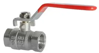

My aunt has an ancient kind of washing machine that has no automatic control of incoming water. That is, to operate it, you manually open a valve in the wall, similar to this one:
water valve
This valve is connected to a hose that feeds directly to the washer. You wait for the drum to fill up (it takes a few minutes), and then you manually close the valve. You can let it start tumbling while it is filling up.
This has worked for years, but now she's having memory issues; so she opens the valve, leaves the room to do something else, and when she realizes, the washing machine is overflowing and there is water everywhere.
Assuming that it is not possible to simply buy a "modern" washing machine (third world problems), is there some time-controlled mechanism or equivalent solution for handling this kind of situation? I'm assuming a non-industrial setting.

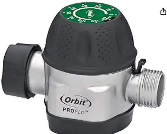

Get her a mechanical Hose Watering Timer.
Easy install inline no plumbing work, no battery, no power
Just measure the time needed to fill the washing machine and make a big marker on the dial.
All she has to do is to turn the dial.
You might want the all metal timer version for indoor use.
Orbit 62041 Metal Mechanical Watering Timer
Found on metal
timer

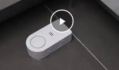

And for additional absolute protection get your aunt this.
It is a water sensor with very loud alarm. Just place it on the floor next to washing machine and it will alert you if only 1/16 of a inch water is present.
You can event get the version that will send a alert to the phone.
I have those all over my home in critical locations.
Found at water alarm
water sensor
