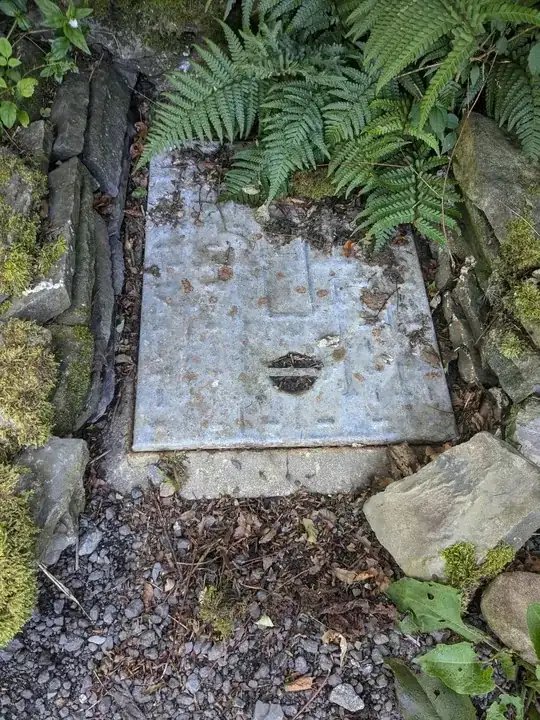

I was, however, surprised that there is sometimes a more intense smell that comes out of the old access cover right outside the house that wasn't replaced. You can see it's just a metal cover. Farther down the lawn are two more plastic sturdy access covers that don't really smell. The blower does smell sometimes, which is annoying, but I guess that's part of the way it works.

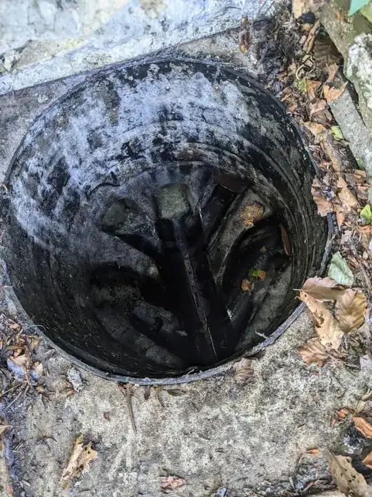

It logically makes sense that there would be smells from the first access port if there are inside the house. I guess my question is how much of this is normal? I'd like to gauge how much smell I should be expecting before trying to replace the access cover with something more permanent, or exploring other ideas. It's typically not that bad but on one day the whole front of the house smelled and you could smell it inside the car when driving up. That seems quite a lot for a new plant, even if the access cover isn't plastic.
That image appears to show a sewer sump basin without a sealing lid. These are common with french drains and other rainwater systems, but with sewer lines you want a basin or sump that has a sealed lid. Typically the plastic basin has a lid with a rubber seal, and it is screwed onto the basin to make the seal airtight. I don't see a lip to hold a lid on that one, so it might be necessary to replace the entire basin with one that has a lid.
