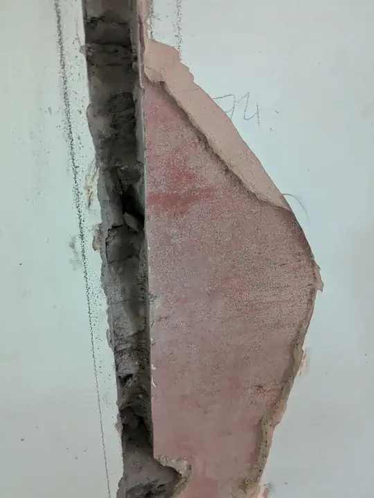

I had a plasterer with 47 years of experience come to see our old stone farmhouse. In one room, the electrician has cut through the wall. Underneath the gypsum plaster is a layer of what the plasterer said was sand cement on top of the stone.
While describing what he could do, he mentioned taking it back to the sand cement, which he called the 'original' layer put on the stone. He would put wood insulation and then lime plaster on top of this.
