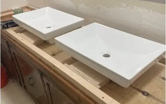

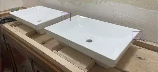

I have these (otherwise) beautiful inset sinks. There is one aesthetic issue I would much like to address: the manufacturer has imprinted their logo into the side. The logos are burnt in: they're not stickers unfortunately. It messes with the all-white/clean image that is intended to be portrayed. It actually makes a bigger (negative) impression than might be expected from the photo; it grabs your attention.
I'm looking for thoughts on how to hide this. For the short term I'm going to put some white slim foam/tape over it. I just don't want to see the logos. White please. That's not a very good longer term solution. My experience with ceramic repair pastes is quite poor; they don't go on smooth and make the sink look broken.

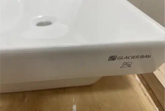

Here is a closer shot for the Semi-recessed vessel sink

That is a slip-painted logo, fired into the product. There is no reasonable way to remove it.
Options:
  • As suggested in a comment, if you rotate the sink, it hides the logo better.
  • Return the sinks and demand logo-free versions.
That's it.
Since this is not one of those stamped and lettered varieties, but rather slip painted underneath the final glaze, even an artist sign painter would find it hard to paint over the lettering and logo without it looking terrible.
If you have some decal material you think will work and you can stand replacing them regularly as they get grungy then this is probably your cheapest option. A decal won't every really match the glaze, reflection, and colour but if it is an option you can stomach then there's your answer.
I think my eye would see a rectangle of grungy decal more than manufacturer's logo my eye wouldn't even see in a week.

In lieu of a very slim tape-like material that can be placed above the logos [and which would reliably remain clean] I am likely to install the sinks backwards. Here is what they look like in that case:
The differences:
  • the front is nearly vertical instead of inclined inwards
  • no logos!
The clean/white [logo-less] look is worth whatever the slight cost is of having the straight front instead of the intended slanted one.
