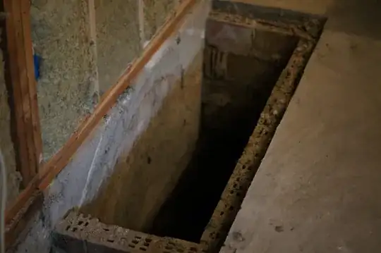

I removed a chimney from my house earlier this year. After everything was cleaned up, I was left with this big hole:
The hole where my chimney used to be
I have two questions: (1) How do I know what type of concrete to use? (2) How do I prep the hole before pouring/placing the concrete?
Some info: The hole is in my garage. It's about 2 or 3 feet deep. Surrounded on three sides by chimney brick and one side by the crawlspace foundation of my house. The bottom is dirt. The garage cement is pretty smooth, which you can see from the picture.

Backfill the hole with dirt/fill to about 10-12" below the surface. You should compact the soil frequently as you go - don't wait until the end. Wetting it will help compact it. After the soil add 6-8" of 1/2" crushed gravel. Compact this. Last, add 4-6" of concrete.
Unless you plan on parking something exceptionally heavy, you can use any concrete really - 2000-5000psi.
