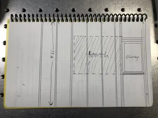

How would a roughly 4ft x 4ft hearth with a wood stove impact this? I made a sketch (not to scale). I estimate the total weight over this 16sqf area would 1200lbs, located essentially mid span. I have not found anything written on how to understand floor load and span with respect to relatively concentrated permanent loads. I find this surprising since it seems relevant to common things like kitchen islands, pianos, stoves, and fish tanks. Back of the napkin estimates can really help you know when you're about to have issues...

1200lb/16sqf = 75psfrough diagram That seems excessive.
