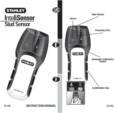

From the Stanley IntelliSensor™ Stud Sensor instruction manual.

Calibration:
  • Hold the IntelliSensor™ Stud Sensor flat against the surface, making firm contact.
  • Locate the activation switch on the right-hand side of the unit – press and hold in. The red LEDs will briefly flash and the green LED “Power” light will go on and remain on. Keep holding the activation switch during all of the following procedures.
Step 1
Note: While calibrating, the IntelliSensor™ Stud Sensor must not be placed directly over a stud, dense material such as metal, or over a wet or newly painted area, or it will not properly calibrate. Move to a different location and try again
Usage:
  • Slide the IntelliSensor™ unit slowly across the surface in a straight line. Step 2
    As it moves closer to the stud, red LEDs will go on. When it detects the stud edge, the top LED will go on and an audio tone will sound.
    Step 3
  • Use the handy pencil hole marker on the IntelliSensor™ unit to mark the stud edge.
  • Double check stud location by coming from the opposite direction. Make additional markings. The midpoint of the two marks indicates the stud center.
    Step 4Step 5
