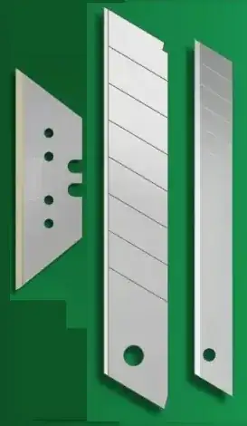

What the edge bevel does utility knife blades have?

Of course the version at left, the non-breakaway utility knife blade, is widely available in packs of 10-100. Websearch will easily find suppliers, or walk into any home center or most hardware stores.
