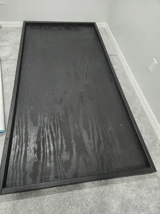

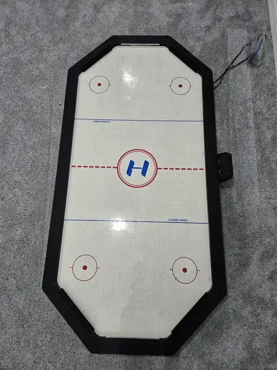

I have a 4x8 plywood with walls around the corners built using 2x4. It's very heavy. Kids are going to build structures using Lego on the plywood tabletop. I want to place the tabletop on top of something so kids can stand and work on it. I have a air hockey table approximately 3ft x 6ft that I am hoping to use by placing tabletop on it. One problem with this approach is tabletop can begin to slide and move around as kids lean on it. So the question is, how to affix tabletop to the air hockey table so the tabletop wouldnt move and when the season is over I can remove the tabletop and store it away. I thought of velcro stripes mot sure if they would be strong enough to attach. Are there other options ? Table Top1 Air hockey table

EDIT: The answer now has a pic of the air hockey table. I've never seen one that's not rectangular. The shape of the table shouldn't really affect my answer other than the pic is less accurate--but the concept is the same.
HABO's edge idea is still better.

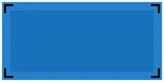

Something along these lines. In this example, the black is the velcro.
Basic diagram of air-hockey table with velcro at the corners
