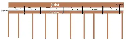

I will be running the top plate parallel to a joist, thus perpendicular to resilient channels. Since it's just a partition wall, I am planning to screw directly through the ceiling drywall and into the joist.
Now, I want to know which would be the best solution to both make the work simple and avoid compromising the resilient channel. Here are some possible solutions:
  1. Screw through drywall, into joist, while avoiding drilling into RC and not tightening too much to avoid compressing the RC. Will this compromise the RC's sound dampening ? This is my desired solution.
Option 1

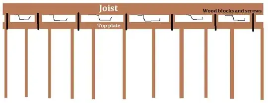

  1. Cut open the drywall on the length of the top plate, add shims until below the RC and screw into shims, into joist. This way, I ensure a small gap so the RC doesn't get compressed. Does this change anything ?
Option 2

Will option 1 really change anything to the RC abilities ? Considering there are plenty of other walls built before the RC that are fastened to the joists in the basement, does one additional wall really change anything ? Are there alternatives ?

Depends what the purpose of the resilient channel is, and if the wall is load bearing or not. If the wall partition is not load bearing, which I assume based on Joist direction, you can fasten the top plate to the resilient channel itself. This may be preferred especially if the resilient channel is serving as a component in an acoustic rated floor system or fire rating.
